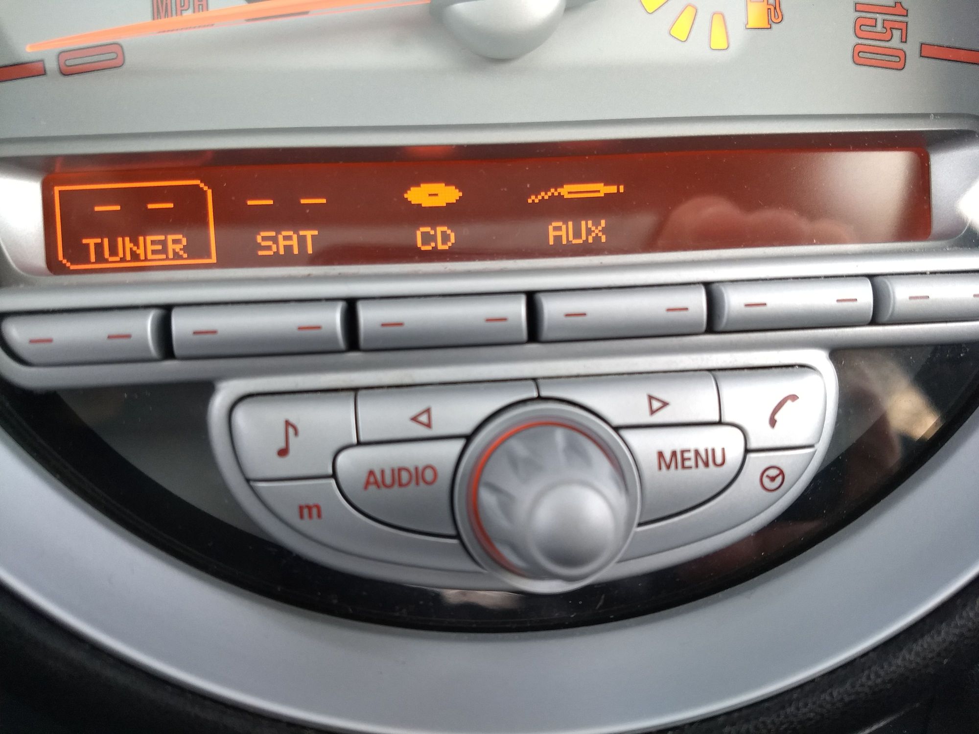

Hi all,
I have a '07 R56 where the radio tuner and SAT selections no longer respond. When I select the Audio button on the radio, the Tuner and SAT icons are two dashes. If I select either, the radio simply does not respond. Worked fine the previous day when I parked it! What gives? I've tried disconnecting/reconnecting the battery but there's no change.

https://cimg8.ibsrv.net/gimg/minicoo...4fd1fb28af.jpgTuner and SAT icons missing
Has anyone seen this before? The Tuner and Satellite icons disappeared and now neither buttons respond. WTF?

ItalianJobRedMini 05-01-2023 08:17 PM
Did you figure this out?
I have this same issue and been trying to figure it out, what did you do to resolve this?

Pootietang 05-04-2023 11:20 AM
Was told by the dealer it was the satellite radio tuner under the passenger seat. Fiber signal loss at the tuner. Sold the car before I could find one at a salvage yard.
You might try bypassing the tuner with a jumper. Although I don't know where you might find a suitable laser jumper. Assuming all MINI's of that year are wired the same, those without the satellite radio option might have a factory jumper in place. Worth checking.
Good luck!
