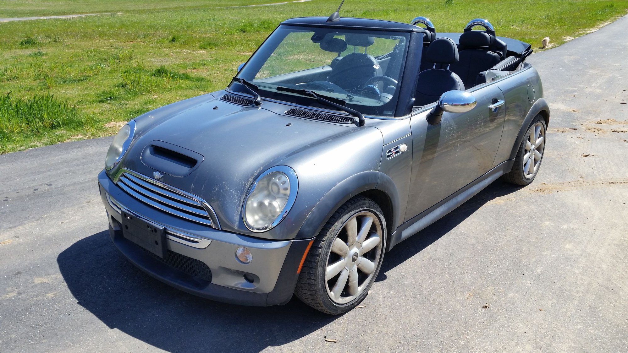

Good day all!!

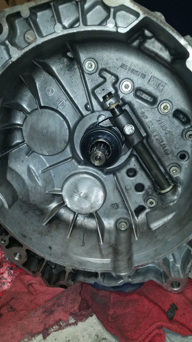

Here is a little history on my 08 ragtop S manual trans... I got this for the grand total of $2200 with transmission issues... It started and ran great... No clutch pedal and it made a loud whine when running at idle... I started it in first and got it going... I shifted it without the pedal by matching the next gear to the correct speed... So it worked... It was solid, for the most part... and included a colony of ants... UGH!

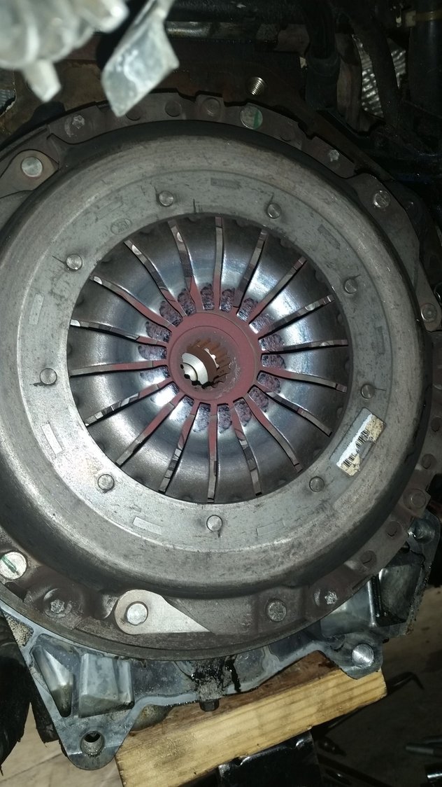

I got it home and pulled the trans... Melted throw-out bearing...

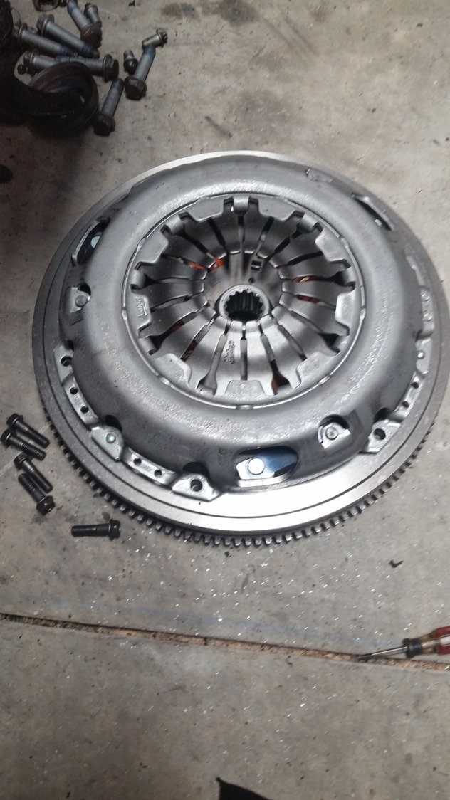

New clutch and solid flywheel combo that saved two pounds...

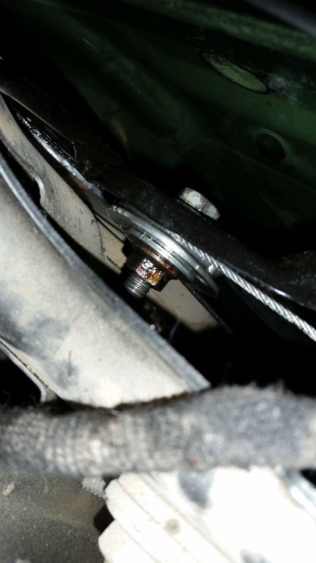

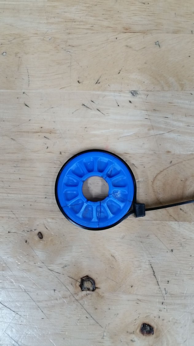

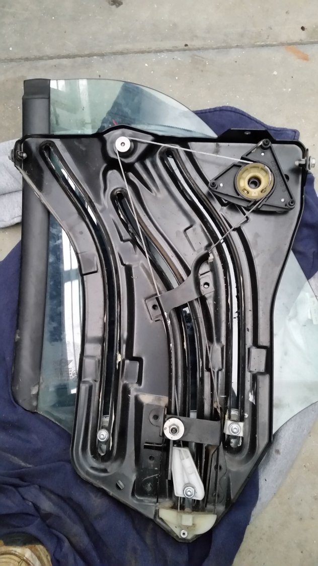

Pass rear window regulator was wound up around the spool... I pulled it apart, straightened the bends in the wire rope and wound it up again... It broke the blue wheel, so I fab'd one quickly out of aluminium... Not my best work, but it is hidden...

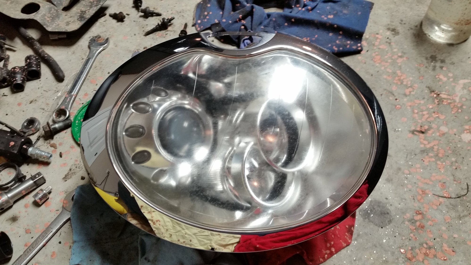

Headlights were hazed over... A little rubbing compound and time on them got them better... I need to do the 2000 grit sandpaper then repeat the rubbing compound...

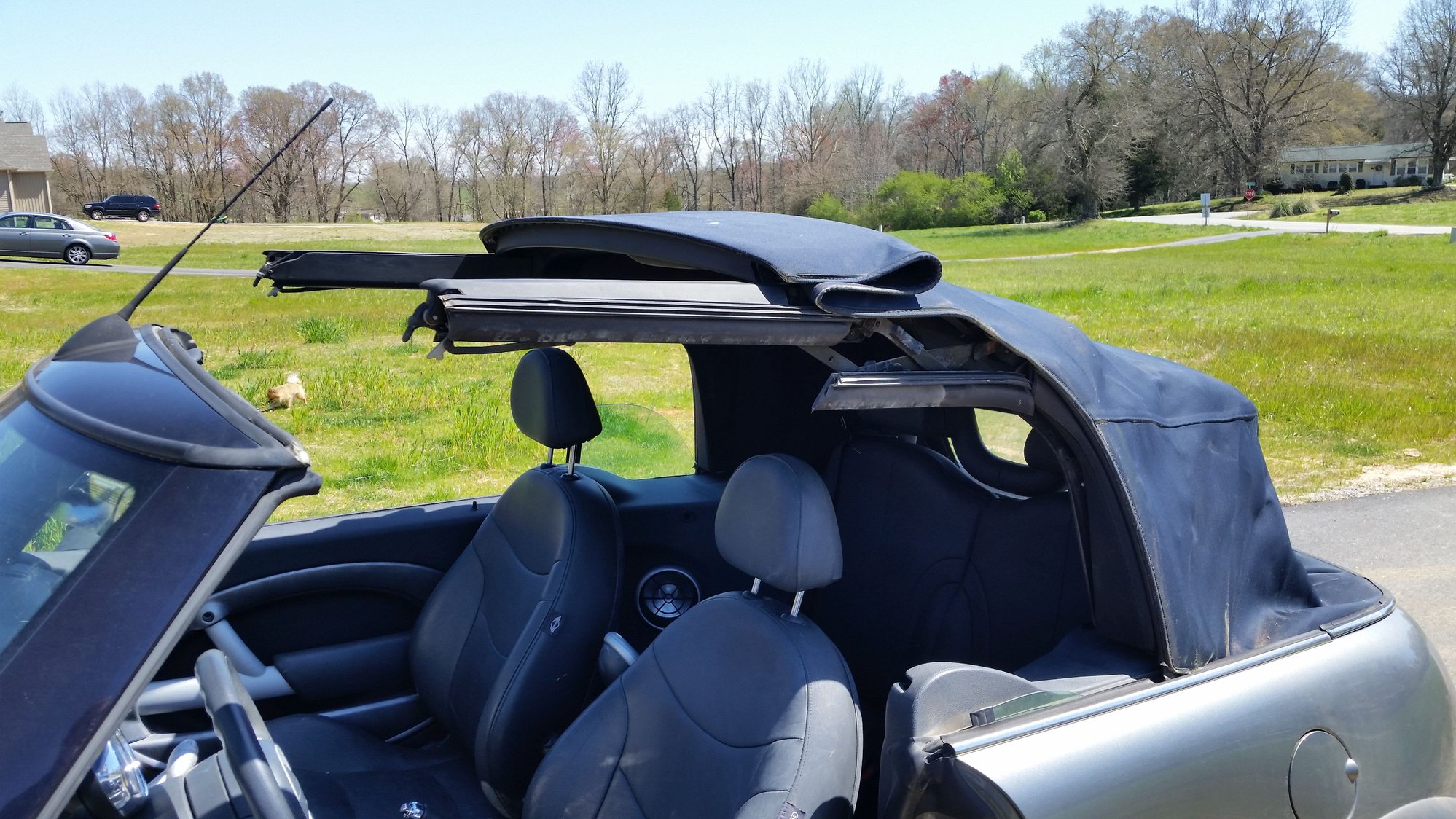

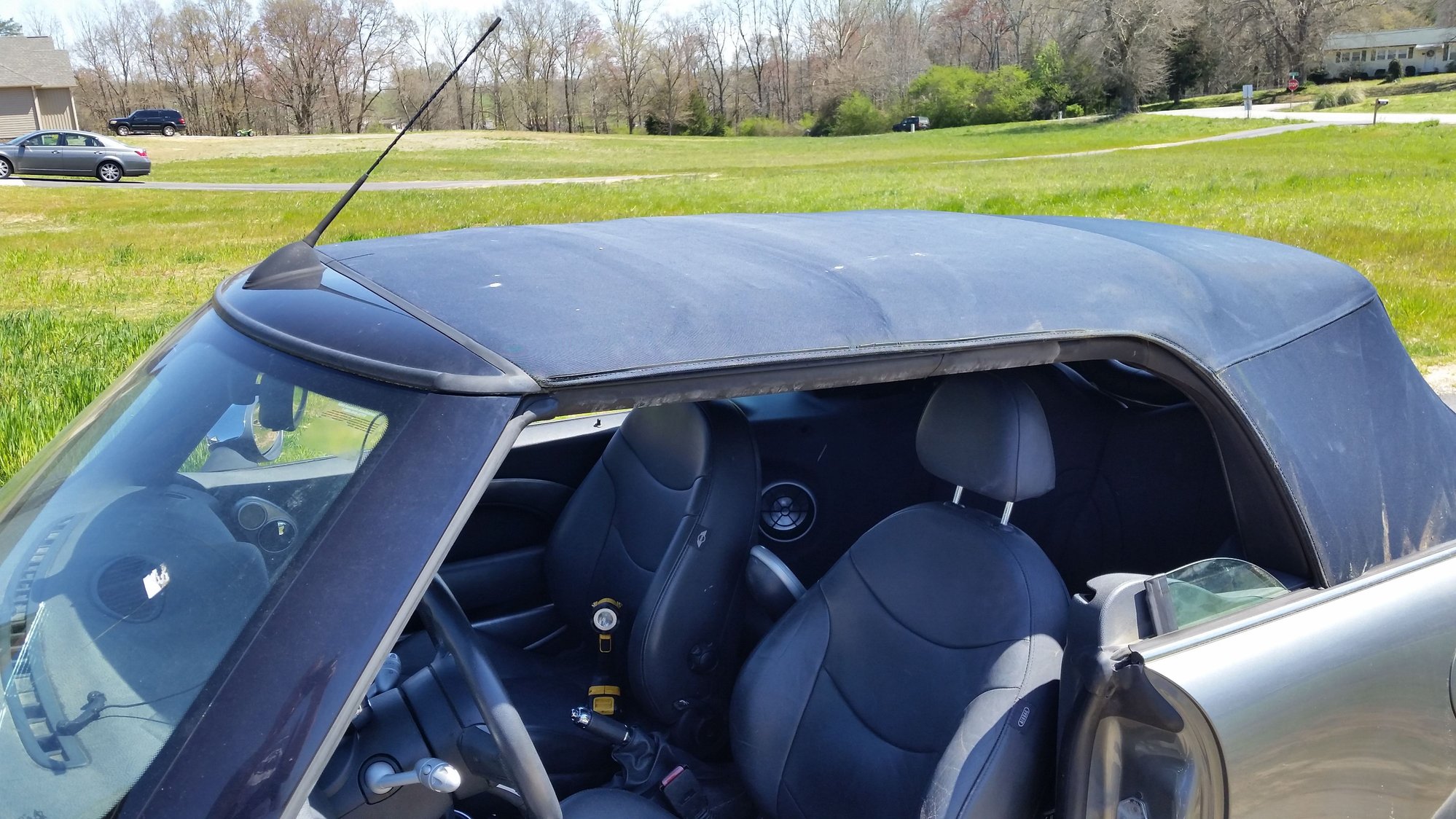

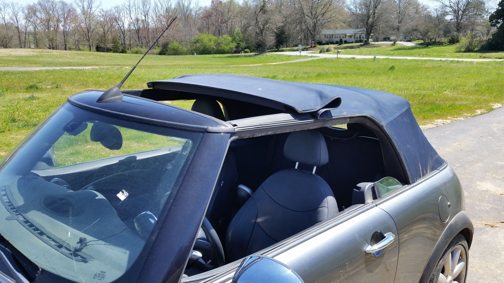

My top worked when I got it... The radio did not... Nothing from the radio at all... The PO had installed a blue Parrot thing and popped the fuse to the back of the radio and main amp fuse... The radio comes on, but no sound so I suspect I have the common amp failure... So, back to the top... It worked until I replaced the radio fuses... Now I have no communication from the amp, nor the CVM (top module) when I hook up the car to the laptop... Swapping in a spare CVM did nothing... Thoughts on this one?!

I put this back together to get the dimensions... I need to make a better set-up... The one I have in there working is just not to my liking...
That top left most pivot is where the blue wheel should be... I pulled that pin and put a bolt with the fab'd gear on it...
