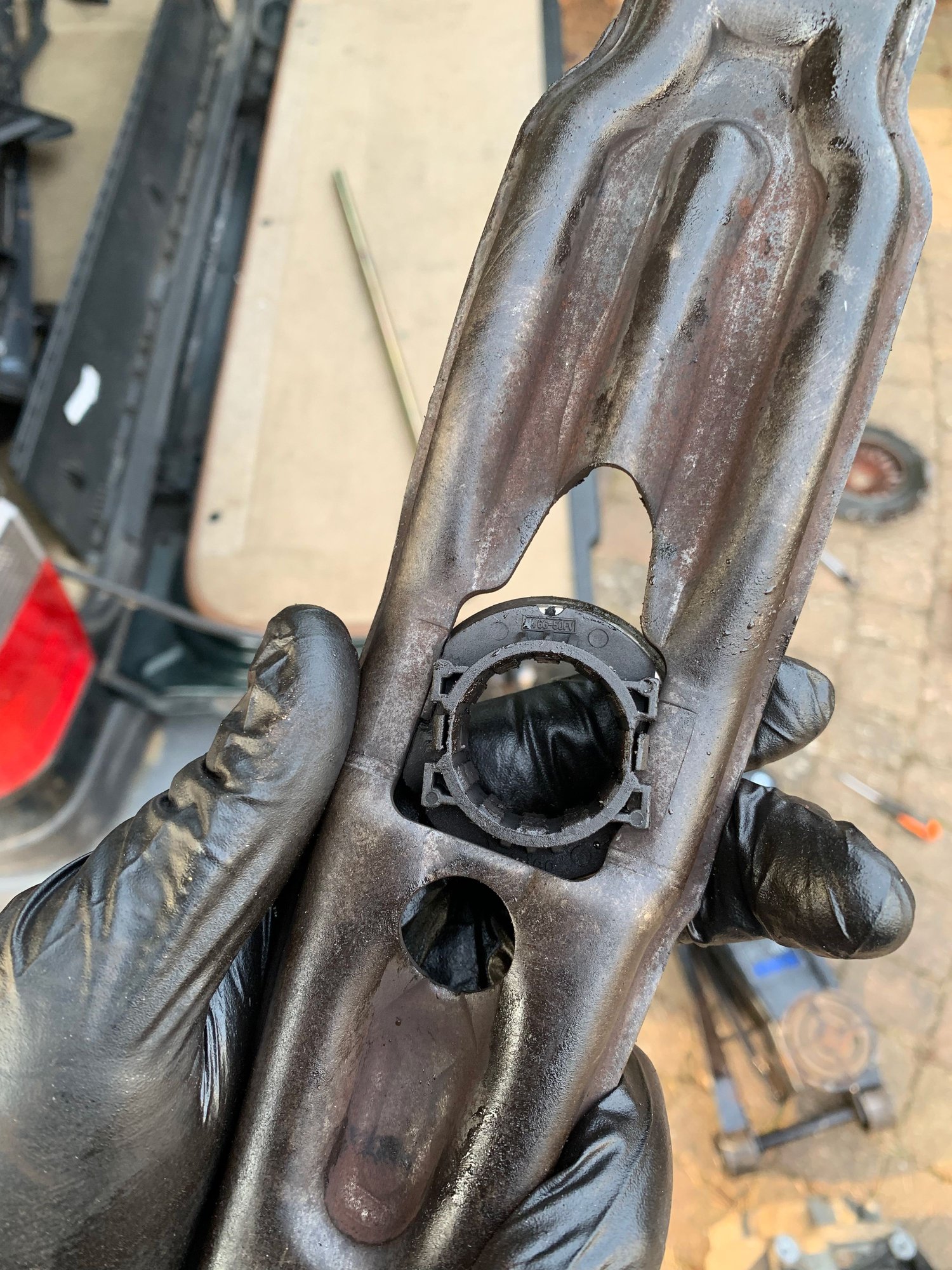

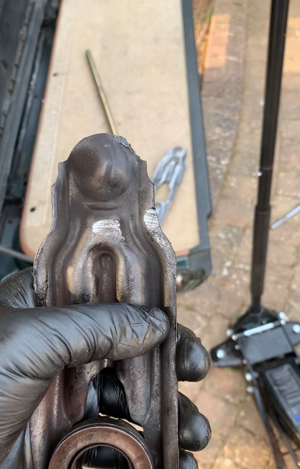

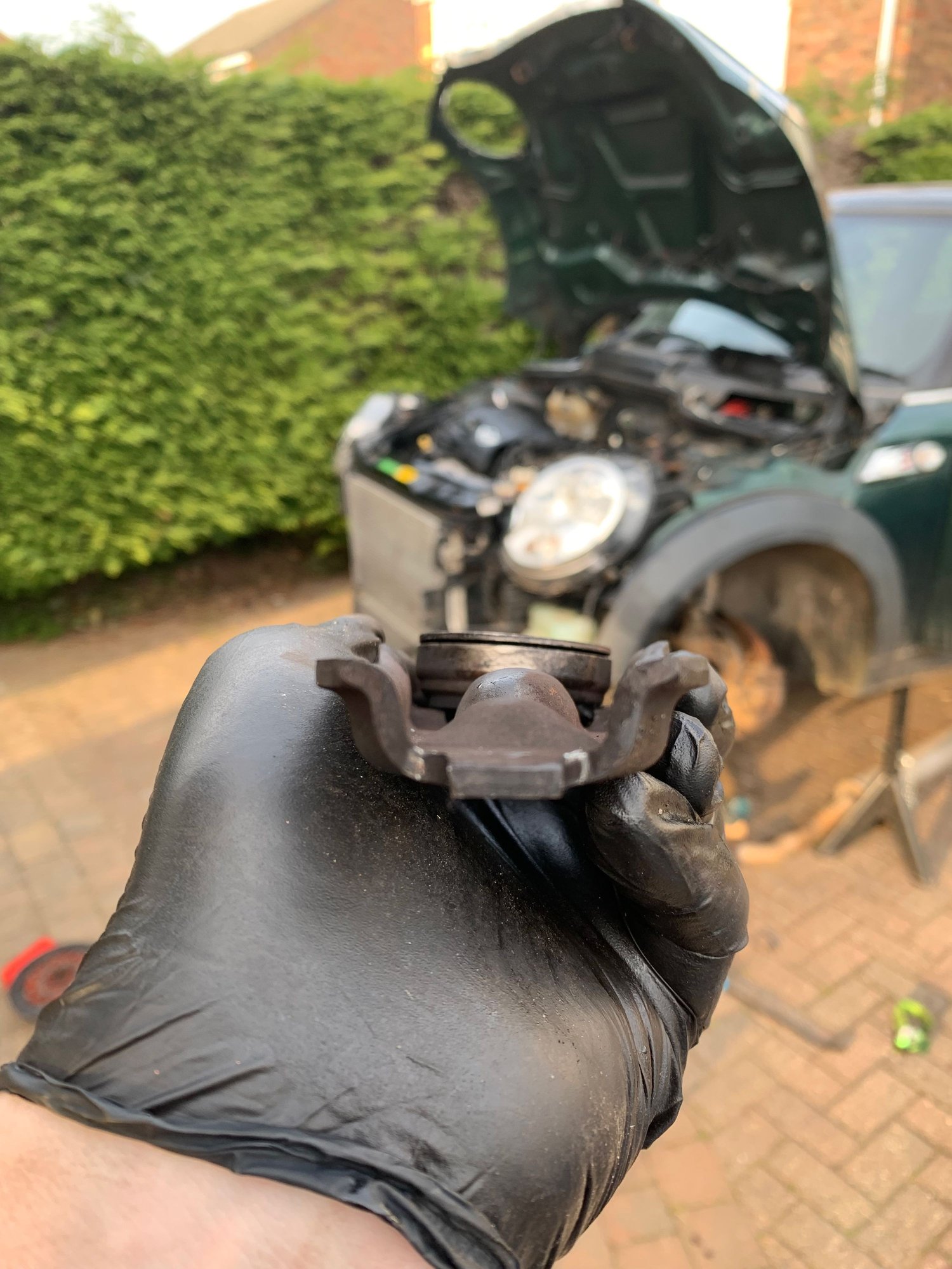

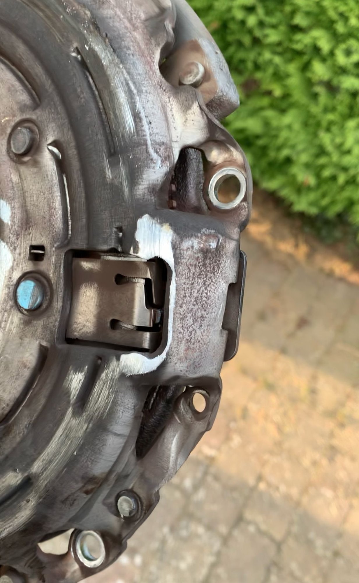

I'm guessing the original posters here have since found out the cause of this noise, but for completeness and to help the next lost soul coming here for answers, I have found the cause of the noise (For me at least).
In short, it was the throw out bearing causing the issue.
The full story.
So, for me the sound was only when the clutch was fully depressed, such as it would be for start up, you could then engage gears without hearing the sound again (unless you really put your boot to the carpet). My R56 is an N18 and was given to me as a gift with this god awful noise issue, I had a fair idea what the cause would be but I was told that the last owner had, had the clutch, flywheel, clutch fork and throwout bearing replaced and the noise didn't stop.
The underside of the car seemed like it had been stood in water up to it's axels for a while as the subframe was almost completely rust covered, but having got that off and the bell housing too I was surprised to see that not only was my hunch right (TO bearing) but just how spectacularly it had gone!
IT looked like the TO Bearing has come out of position some how and so it's no longer straight, meaning it can't slide freely up and down the input shaft anymore, and the clutch fork is grinding against the clutch cover plate and making that horrible noise.
Attached is a video with the original noise and then pictures of the damaged parts.
I hope these can help someone at some point as it's been a right pain in my ar$e!
