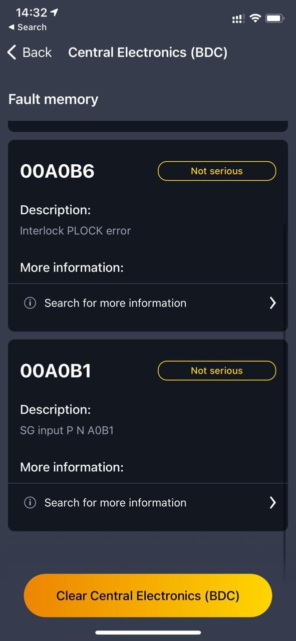

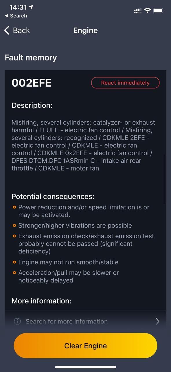

I have also had a friend of mine scan the vehicle with an OBD Scanner and have got some readings which are attached.
Octane Booster from LiquiMoly
Injection Cleaner from LiquiMoly
CARLY OBD 2 SCANNER Reading 1
Carly OBD 2 Scanner Reading 2
Carly OBD 2 Scanner Reading 3
Carly OBD 2 Scanner Reading 4
Carly OBD2 Scanner Reading 5
Carly OBD 2 Scanner Reading 6
Carly OBD 2 Scanner Reading 7
Carly OBD 2 Scanner Reading 8
Carly OBD 2 Scanner Reading 9
Carly OBD 2 Scanner Reading 10

The OBD2 Scanner showed the same readings on Cylinder Misfire and Injection Shutdown.

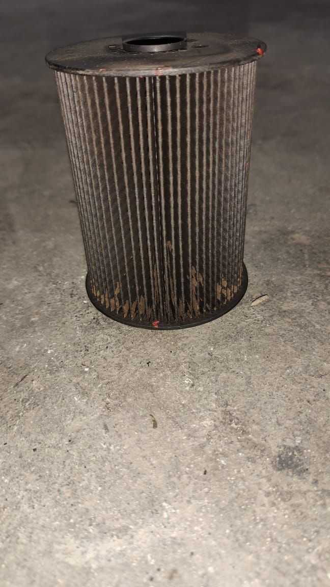

We Opened up the Fuel Filter housing after removing the rear seat.
The Fuel filter was absolutely black and clogged with dirt.
It is the original filter that came with the car from the Factory and I have done 47000Kms in this car which is the same as 30000 miles.
I understand that BMW say these are Lifetime Products but I take issue with that because this is not logical.

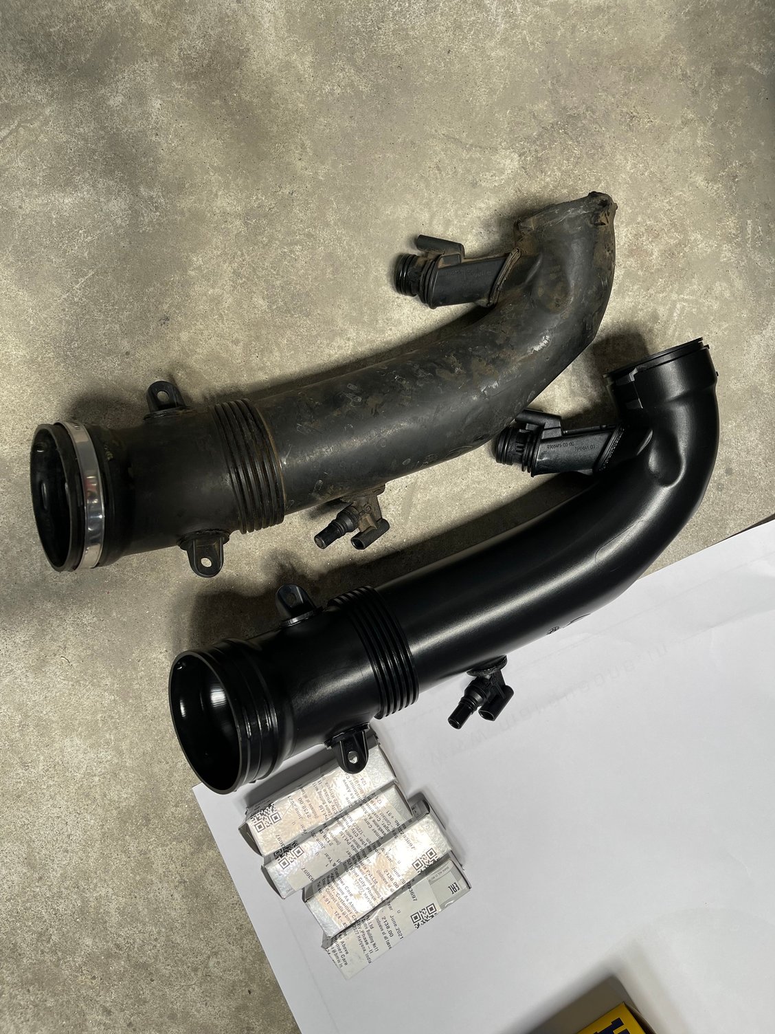

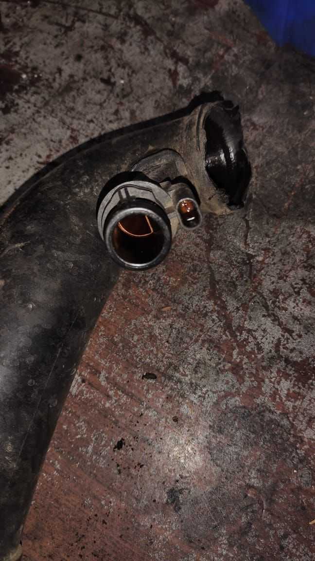

The car is 9 years old so we also ran a check on some of the hoses. Looks like the Turbo Hose Air Duct Intake Boot is worn down especially at the edges and this requires changing.

The 9 year old Fuel Filter. Crossed 30000miles/ 47000kms
The edges of this intake boot are frayed. Needs changing else the Turbo will leak air.

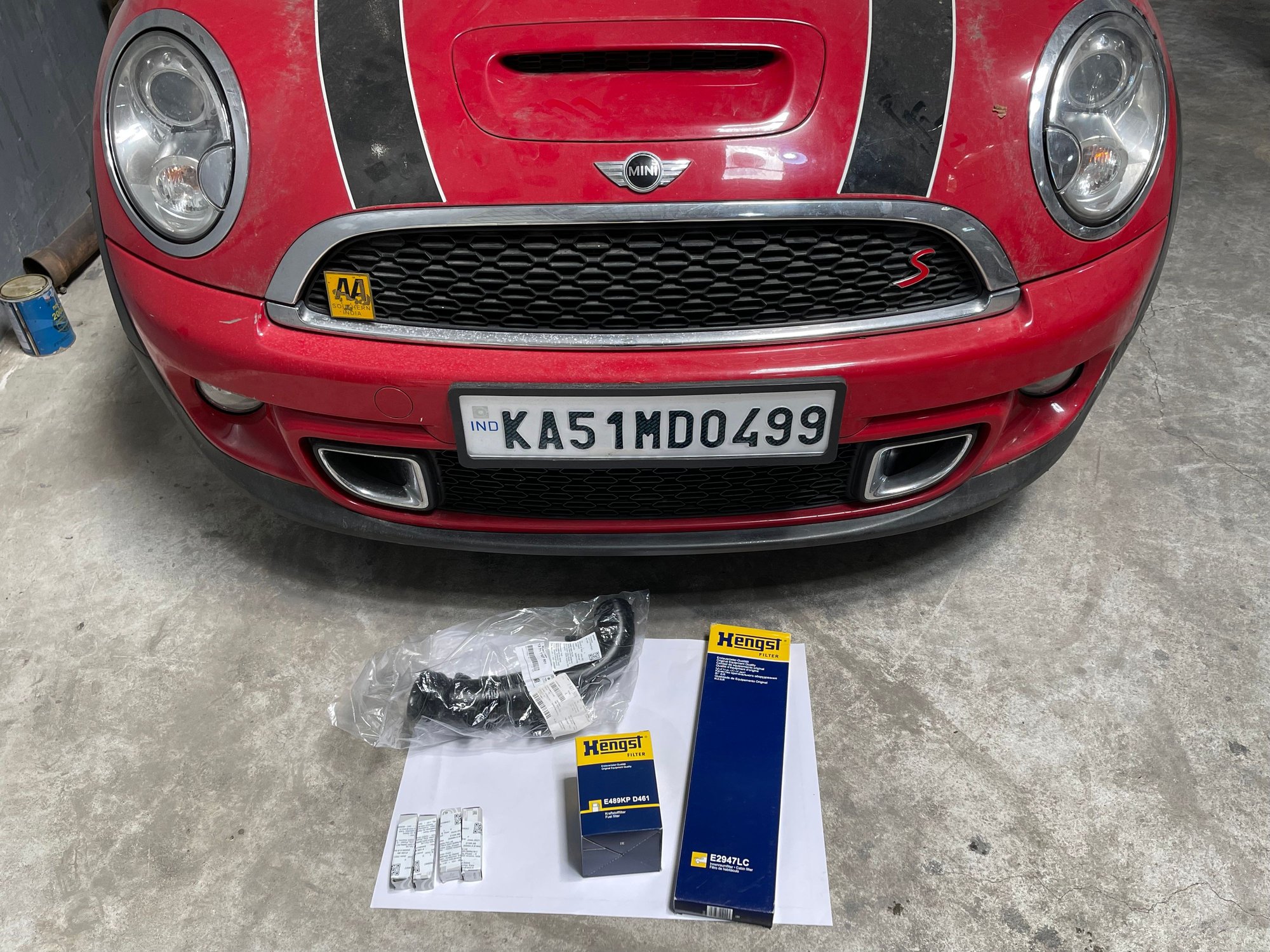

I had ordered the Turbo Hose and Spark Plugs with BMW India. However, these will take 2 full weeks to arrive. I believe they are expected on 6 July… BMW said that they did not have stock of the Fuel Filter and the Cabin Filter and that these would take 46 days to arrive from Germany - can you believe it!
So I simply went on to ECS Tuning and ordered the Cabin Filter (Charcoal type) and the Fuel Filter, the most critical part on Monday the 21st.
And these parts arrived at my doorstep via FEDEX this afternoon 25 June! Yes I had to pay shipping and I also had to pay Customs Duty, but to get parts so fast all the way from the US, is very heartening indeed!
Of course I still have to wait on BMW India for the remaining parts, and only then can I get them on to working on the Cooper S at the garage…
Here is a picture of the filters..
Cabin Filter by KENGST. Sourced from ECS Tuning Ohio USA…arrived in a week’s time via FEDEX. These filters are equivalent to Bosch or Mahle.
Fuel Filter by KENGST. Sourced from ECS Tuning Ohio USA…arrived in a week’s time via FEDEX. These filters are equivalent to Bosch or Mahle.

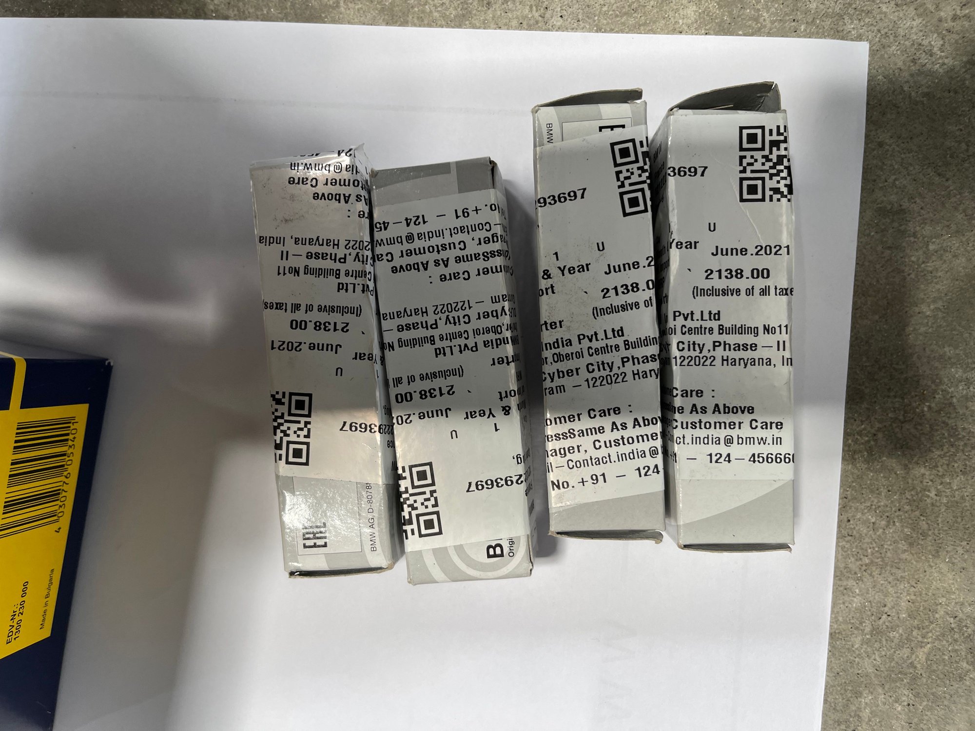

Another update from today. BMW India got the parts in earlier than expected so I went along and picked them up and delivered them at the workshop where my Cooper is sitting.

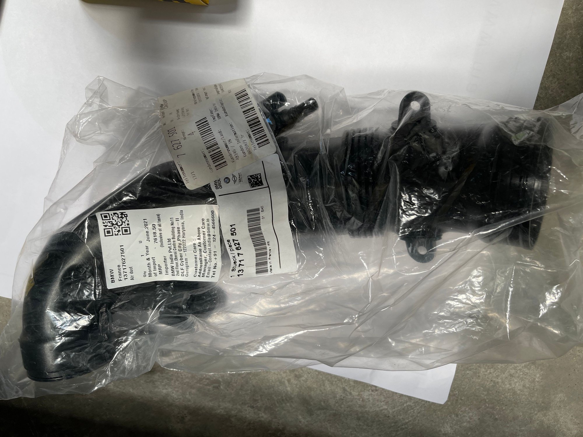

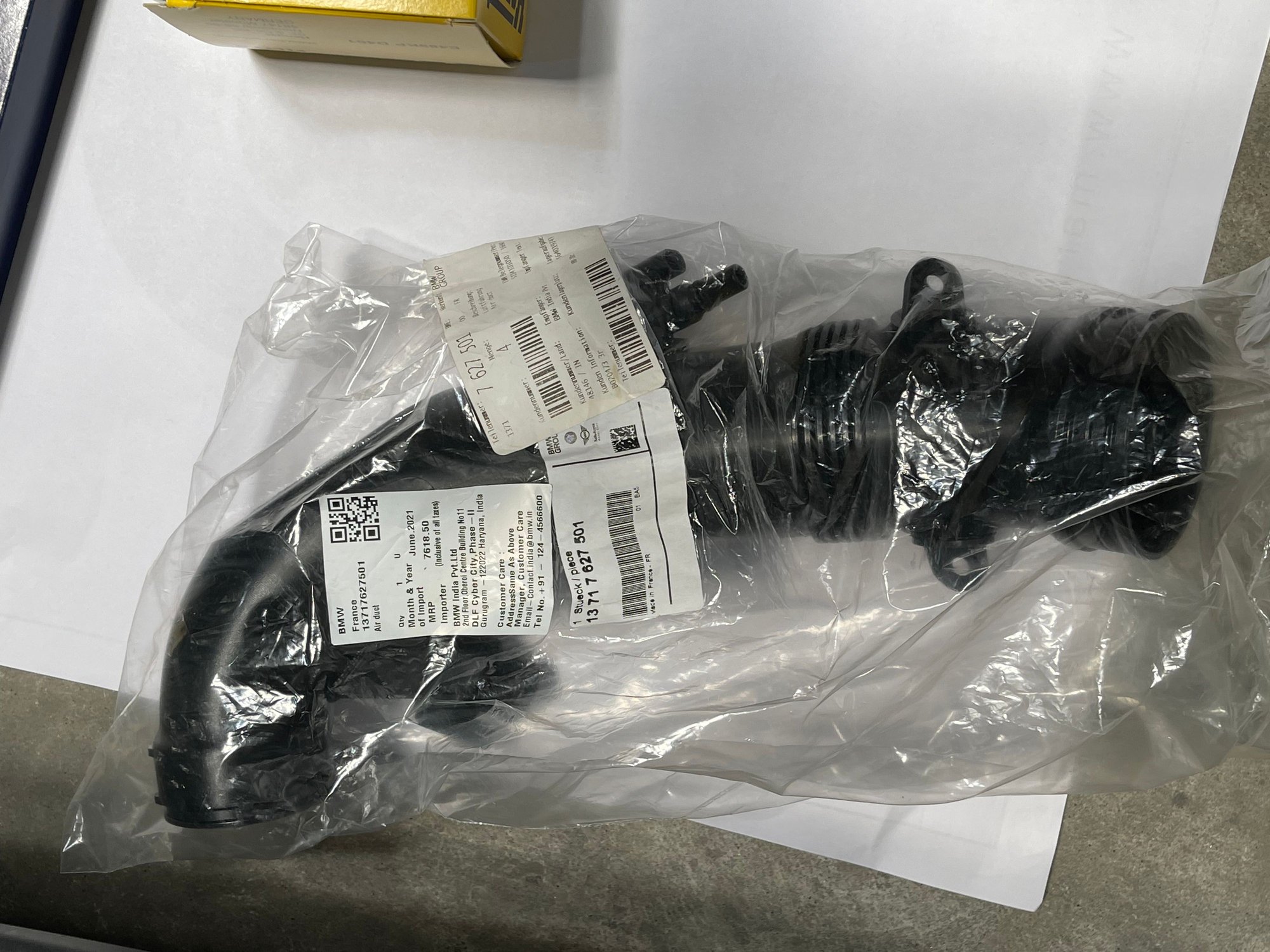

I got the standard BERU spark plugs and OEM Mini Turbo Hose today.
Here are the pics.
Now this evening or so I thing the cleaned Injectors and Fuel Rail etc will be back from the cleaning agent.
And over the next few days I think we ll be able to put the vehicle back together again and test it thoroughly to see if the misfire and stuttering problem is solved.

The old and the new Turbo Hose. Clearly can see where the old one is frayed at the edges.
New OEM MINI Turbo Intake Hose…
New OEM Mini BERU Spark Plugs

And upon scanning it again, the error code that came up was 37DE. Engine Ventilation Heating, activation. Line disconnection, followed by 2EF7 Engine Misfire Fuel Injection deactivation. Etc.
I am reading on the internet that code 37DE means there is a crankcase ventilation heater control circuit malfunction. Reading a Service Bulletin on this, it says due to some DME software change the diagnostic monitoring capability is improved for the engine ventilation and heating system. But apparently if the ventilation heater circuit has some malfunction it will show up in the fault memory. And the bulletins says that we have to verify the integrity of the circuit and the connections. And to verify if the heater relay is installed properly and check the resistance of the circuit which has to be at 12.5-15.5 Ohms.

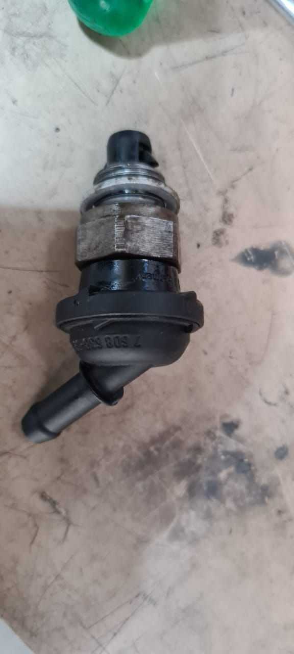

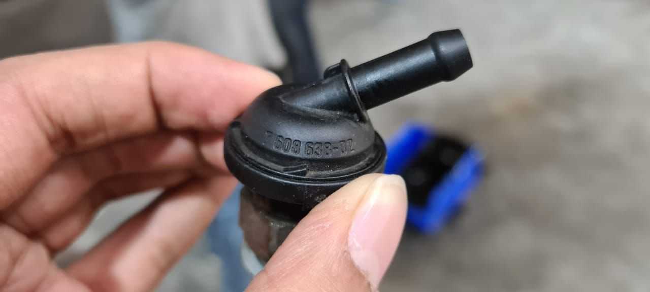

Anyway, we have now narrowed down the fault by consulting with a Senior engineer who worked for both Audi and BMW and is now an independent. He advised us to check the PCV membrane as well as the PCV Intake Hose -because the Positive Crankcase Ventilation situation is clearly and consistently coming out in the fault code.
This is caused by the jamming of a one way valve which can only be accessed by removing the sump itself.
So my friends at the workshop did that and found that the valve indeed was jammed. This valve has a ball inside (similar to the human throat) and if the ball is jammed then the crankcase does not get enough cool air inside and thus malfunctions.
Here are some pictures of the faulty part and the replacement parts that are arriving early next week…
This is the faulty valve. It is attached to a hose. And this goes from the block to the intake. Crankcase vent hose which incorporates the valve.

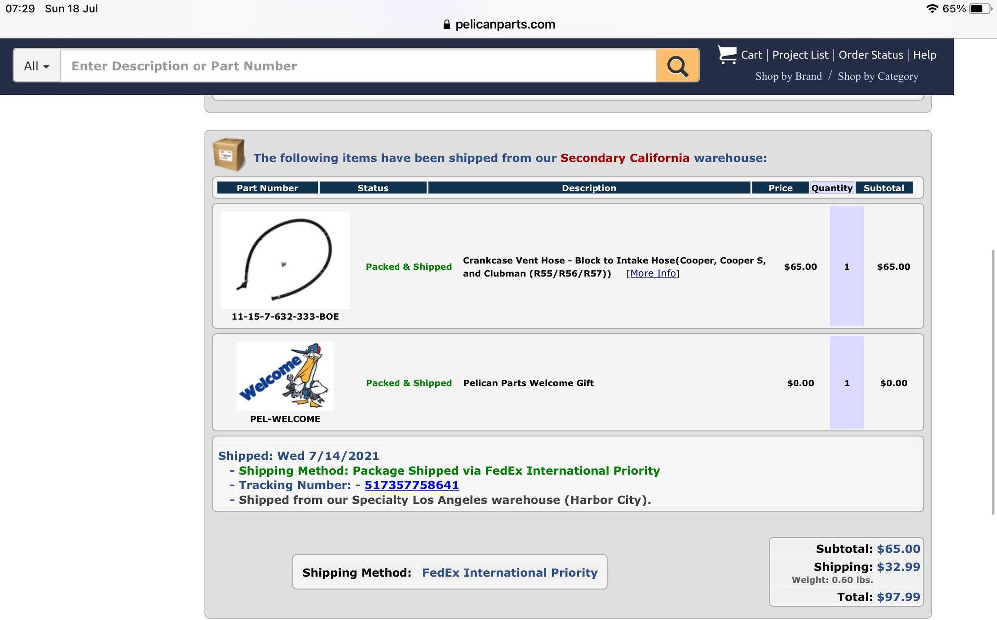

Crankcase vent hose Valve. Hose itself needs replacing. Part NO 11157632333
Crankcase vent hose valve. BMW Part no 11157632333
That’s my order from Pelican Parts….
