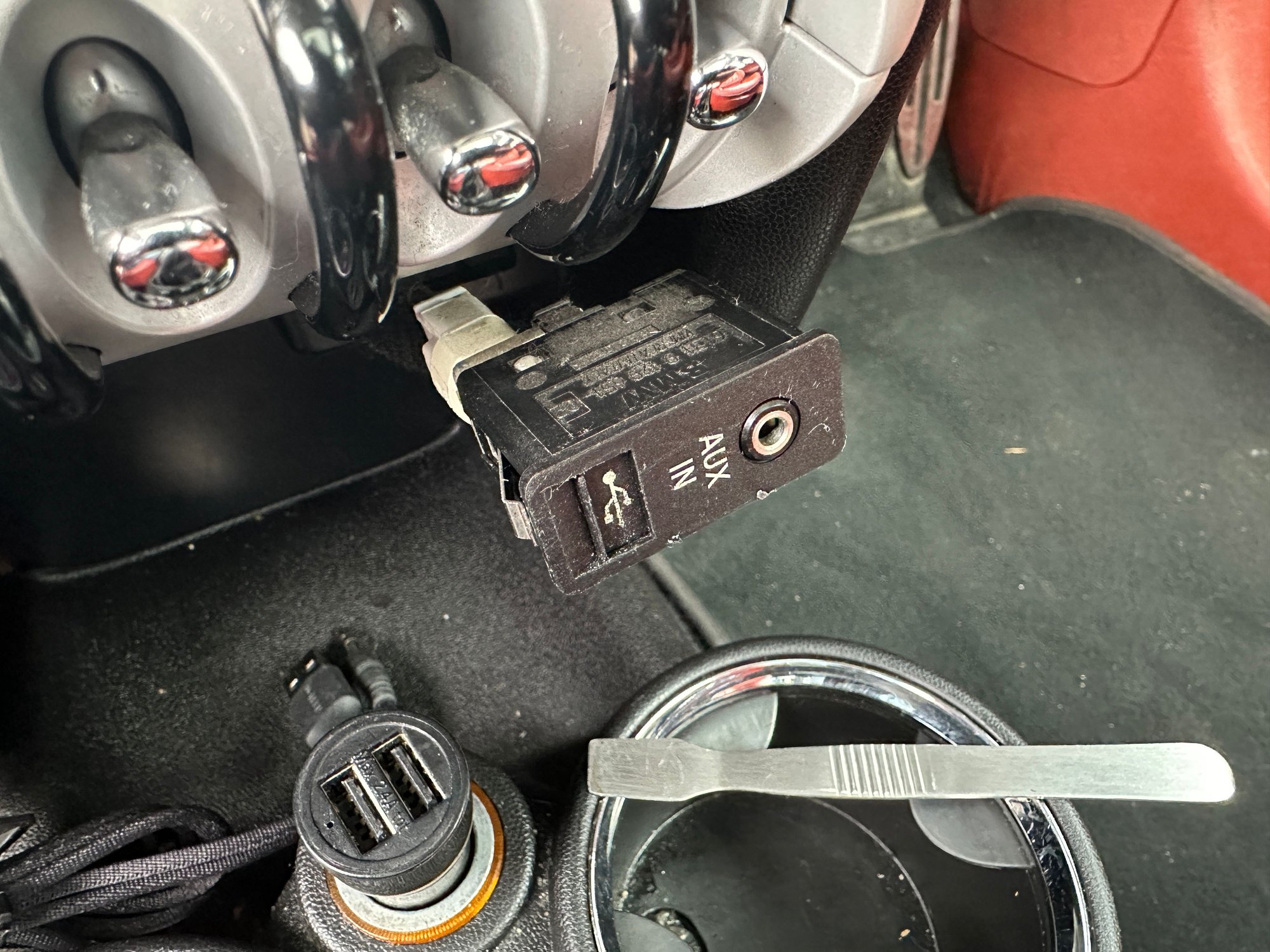

Old Mar 27, 2025 | 04:22 AM
  #6
smashing's Avatar
Joined: Mar 2025
Originally Posted by froward
did anyone ever figure this out?
No need to pull out any panels. I was able to lever out the left side using a metal spudger as shown. As usual, just be careful to wiggle the cables out sufficiently and hold on to them, so that you don't lose them back into the fascia.
