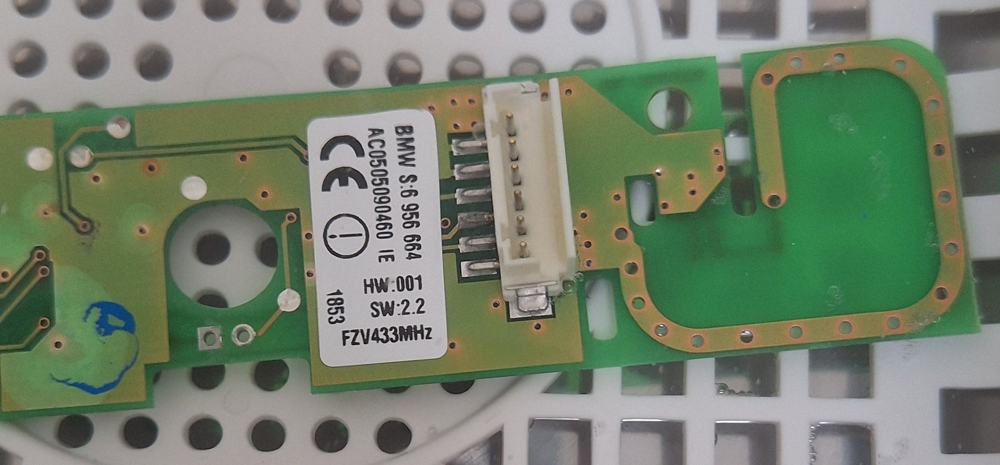

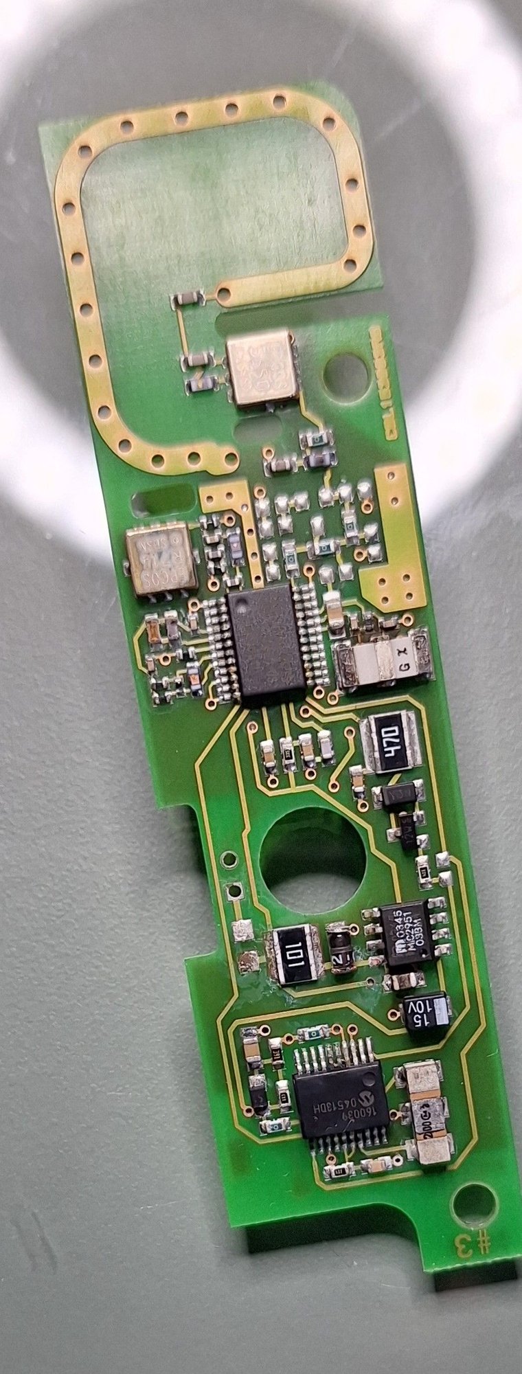

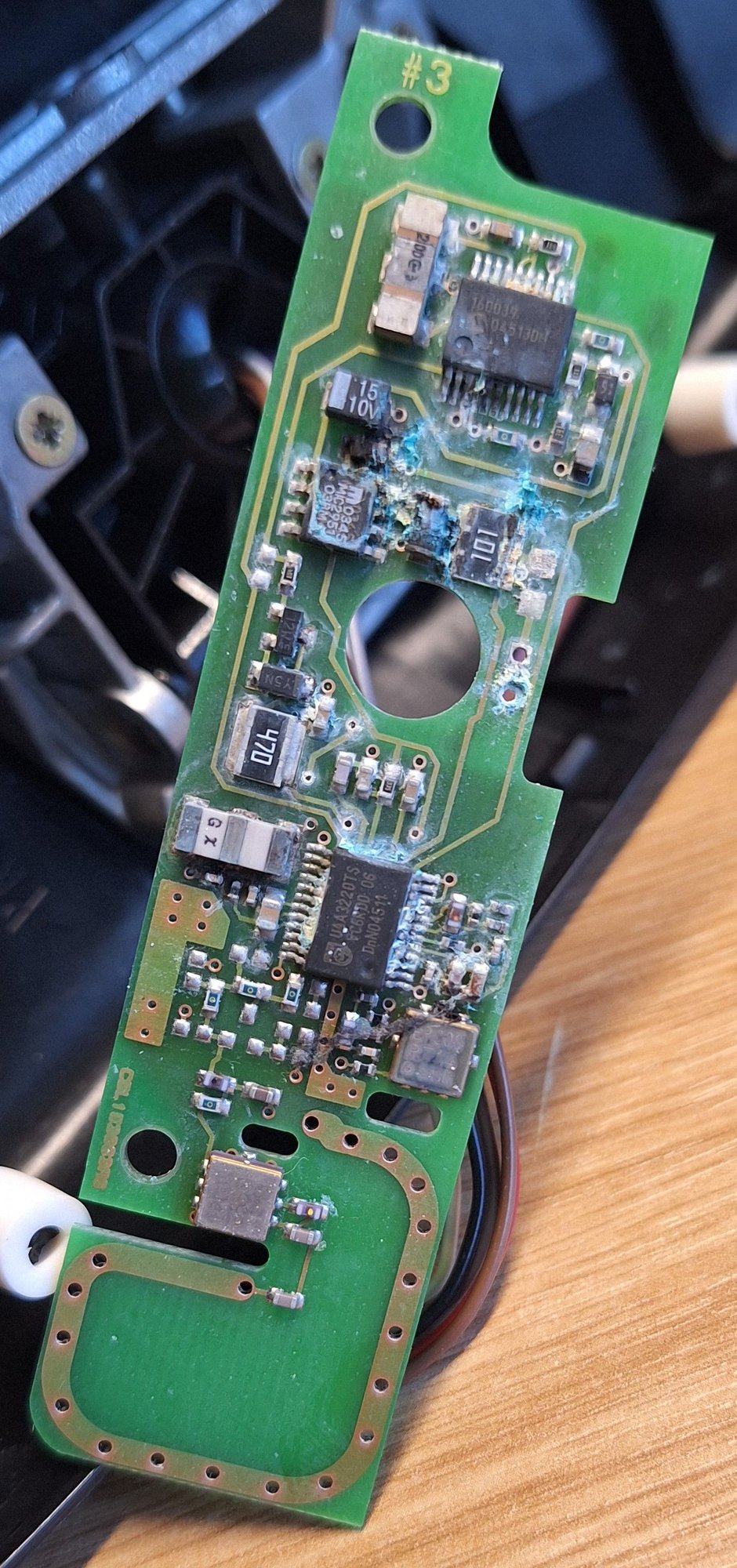

Turns out, as I have an aut dimming rear view mirror, the receiver is simply a PCB, stored inside the mirror housing. After removing the mirror (plenty tips on the internet for that) and prising off the front cover (using a plastic "spludger" - not a sharp screwdriver!!!), I found the board and the probable reason for it not working: the mirror housing had quite a bit of water in it, and the board was showing signs or corrosion (and possible deterioration or a couple of chip pins). Only the UNDERSIDE was damage - the top, which is what you see when you open the mirror, looked fine! So, it seems the water was only just deep enough to affect the undeside of the board, while leaving the top undamaged. See pics (topsde, damaged underside and cleaned underside).
Even after cleaning, the unit is unresponsive. I'll try we working the board (with an SMD re-work station), but I'm guessing I need to find a new one. The only source I've found to date is whole mirror units from scrapped vehicles - I'd prefer just a replacement board.
