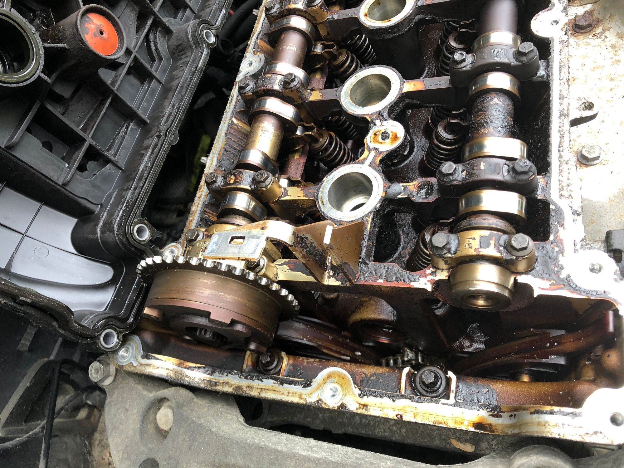

Finally pulled the valve cover off (was avoiding it because I don't want it to be a catastrophic failure. Schrodinger's cat and all.
It was pretty obvious what happened once the valve cover was off; the timing chain guide failed and the engine ate the timing chain. It also sheared off the exhaust cam bolt.
Crossing my fingers that none of the valves got bent but as long as I can extract the bolt from the cam shaft, I'll gladly eat the cost of new valves as long as that is the worst of it.
Ate the timing chain and sheared the cam shaft bolt.
Don't yell at me about the condition of the head. I got the car used and drove it for less than six month before the timing chain guide failed.
