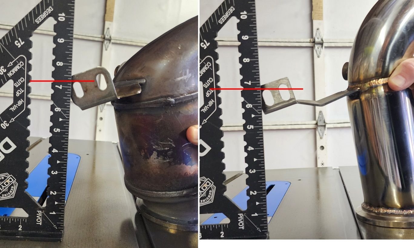

I ordered a Racing Dynamics catless Downpipe from Emnotek.com. When I tried to install it, I discovered that it would not fit. The issues were:
1. The holes for the O2 sensors do not line up with the holes in the heat shield. The downstream hole is off by a full 2 inches. Here is a link to a youtube video of someone else having the exact same problem (see time 11:57)

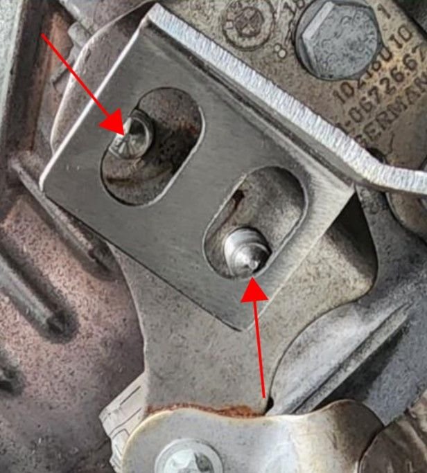

2. The holes on the mounting bracket are too close together, so they won't fit over the bolts (see picture below)
3. Even if the bolts would fit through the holes, when adjusted to the end of the slots in the bracket, the downpipe is still almost an inch from the turbo (see picture below).
I contacted Racing dynamics and explained the issues and sent pictures (see below) showing clearly what the problem was. Their response was as follows:
“We just completed quality control installations of several randomly selected catless and catted downpipes for the Gen III MINI. We installed them all without issue. We have the knowledge, experience and tools to do the job without issue. If your professional installer possesses all three, they should not have had a concern either.”
So basically, they said "We tested some here and there was nothing wrong with them, so there is nothing wrong with yours, and if you had any skill you would be able to install it." This was the most condescending response I have ever gotten from any customer service department.
