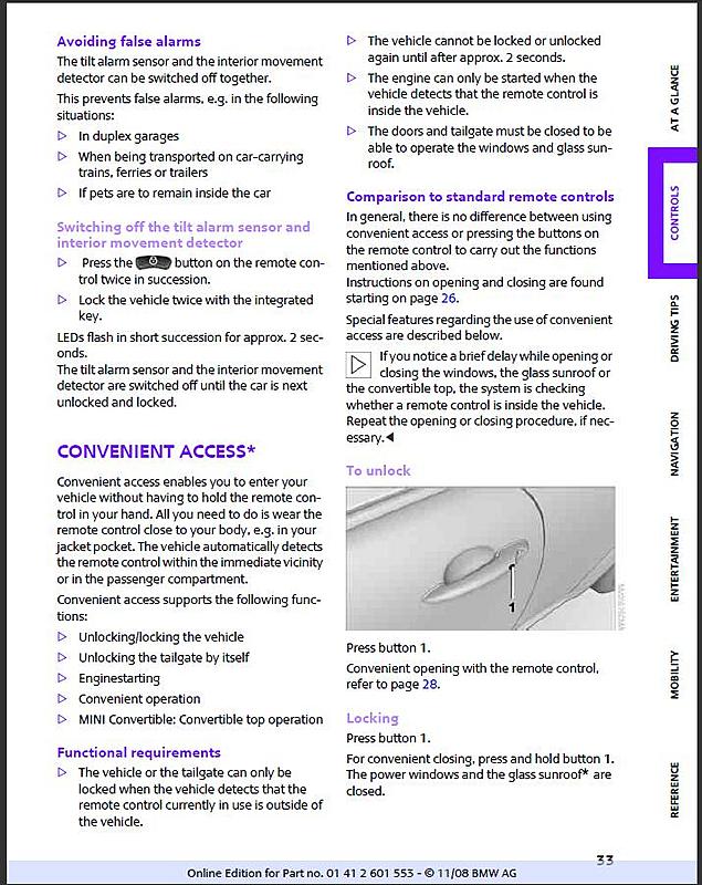

Visual indication of the factory alarm system.
Located at the top of the tach, upper red lens , little cresent shape.
Here is the alarm kit for the R57, has a little more in interior sensor do to it being a convertible. Ultrasonic are are horizontal and behind the door panel and rear side panels. A little different set up then the hardtop.
R57 MINI Convertible Alarm. Part number 65732157425
http://www.ecstuning.com/Search/SiteSearch/65732157425/
Here is a link to the install PDF at the bottom to learn more about the system.
R57, Alarm Retrofit and location of Ultrasonic Module - North American Motoring
Here is the alarm maul page from 2012. Looks like is flashes then pulsates.
Thanks and hope that helps.
