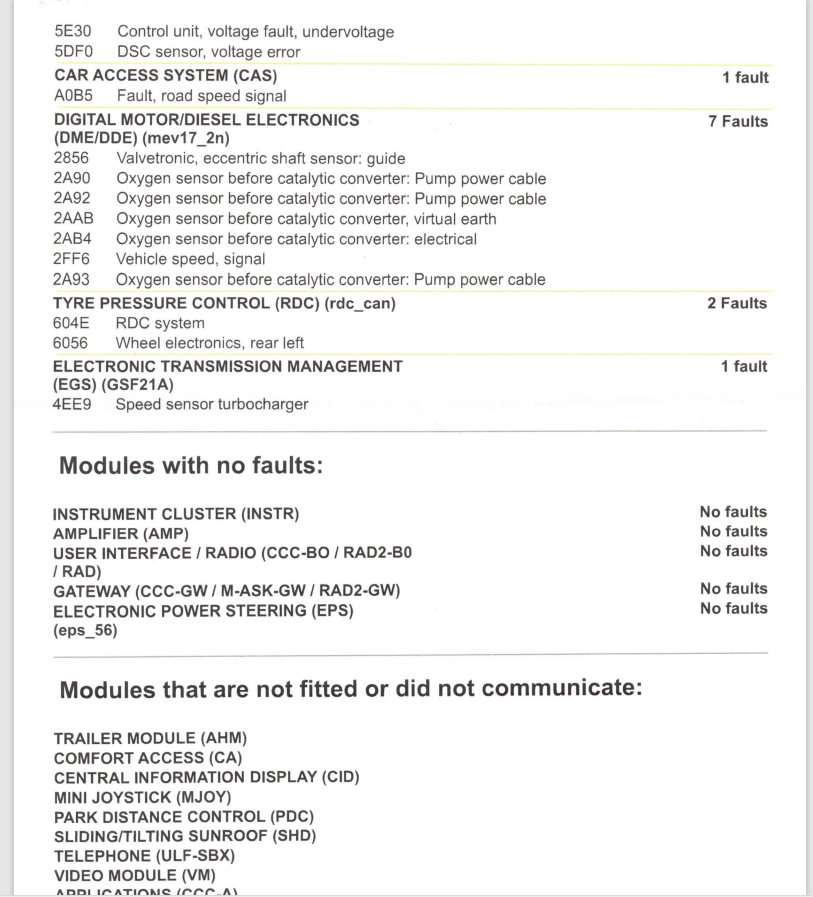

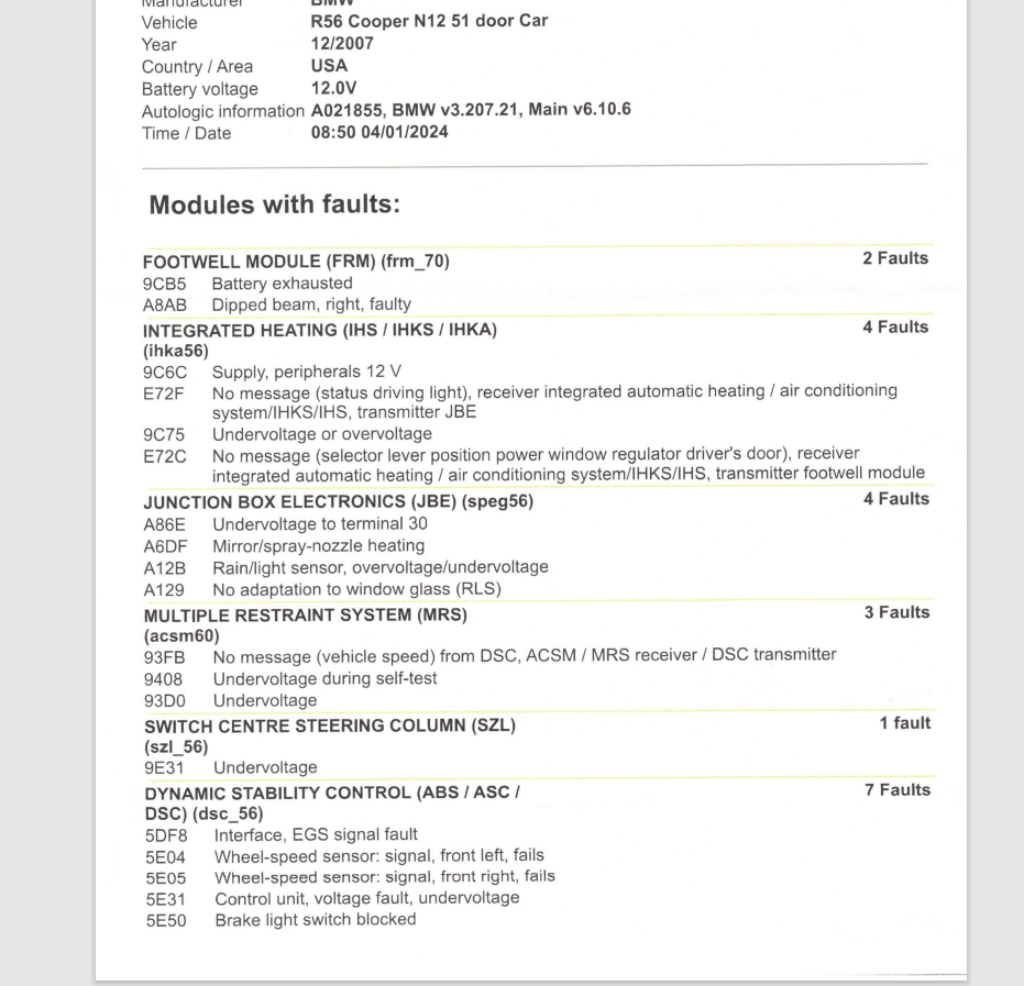

Bought at auction with a dead battery and CEL. Battery replaced (read lots of posts regarding bad batteries and "forgetful ECUs"), using my cheap engine scanner I read codes P1776 & P1777 - as far as I can tell not transmission related but something to do with speed sensors by the tires? Drove around for a day with a new battery to see if the transmission issue went away - didn't work.
Next I brought it to a transmission shop who works with EURO vehicles. Plan is to have them read transmission with their high end reader, reset transmission computer, drive Mini and check tranny fluid. Scan doesn't show anything unusual with transmission other than code 4EE9 which relates to the transmission speed sensor turbocharger. The mechanic is able to replicate the problem and after he updates the software goes for a 20 minute drive. Car drives great and he believes issue is fixed but upon returning to his shop and moving from D to R to get to P he experiences the same jump/jerk as before. He checks transmission fluid and is satisfied with level, plus indicates fluid looks clean - which indicates to him recent replacement. While reading the transmission "live" he advises all values, solenoids and other components report back that they are working A OK.
His final verdict to me was he believes with an issue like I am experiencing I could drive the car another 50-60k with no worries. At the time when the tranny decides to go out just put a rebuilt one in and call it a day. This is definitely a route I am comfortable taking with a lower cost auction vehicle, but if it is at all possible (skill wise and budget) I would like to identify and fix the problem anyway. I will post my diagnostic report. There are a dozen + modules errors listed non transmission related that might indicate something not thought of yet and in general if anyone sees something they would be overly concerned with I am always happy to take friendly advice when offered.
