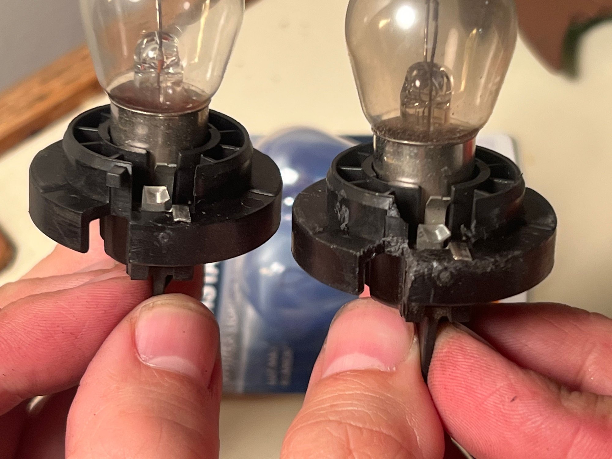

We had to scrape at the melted bit and pryed it up and down to release it. We had to gently use some pliers finallly and then it came out! Below is the picture of the burnt bulb to the right (you can see the scrap’n) and the left is a photo of the middle light which was fine. Good luck!
Chrs.smth
