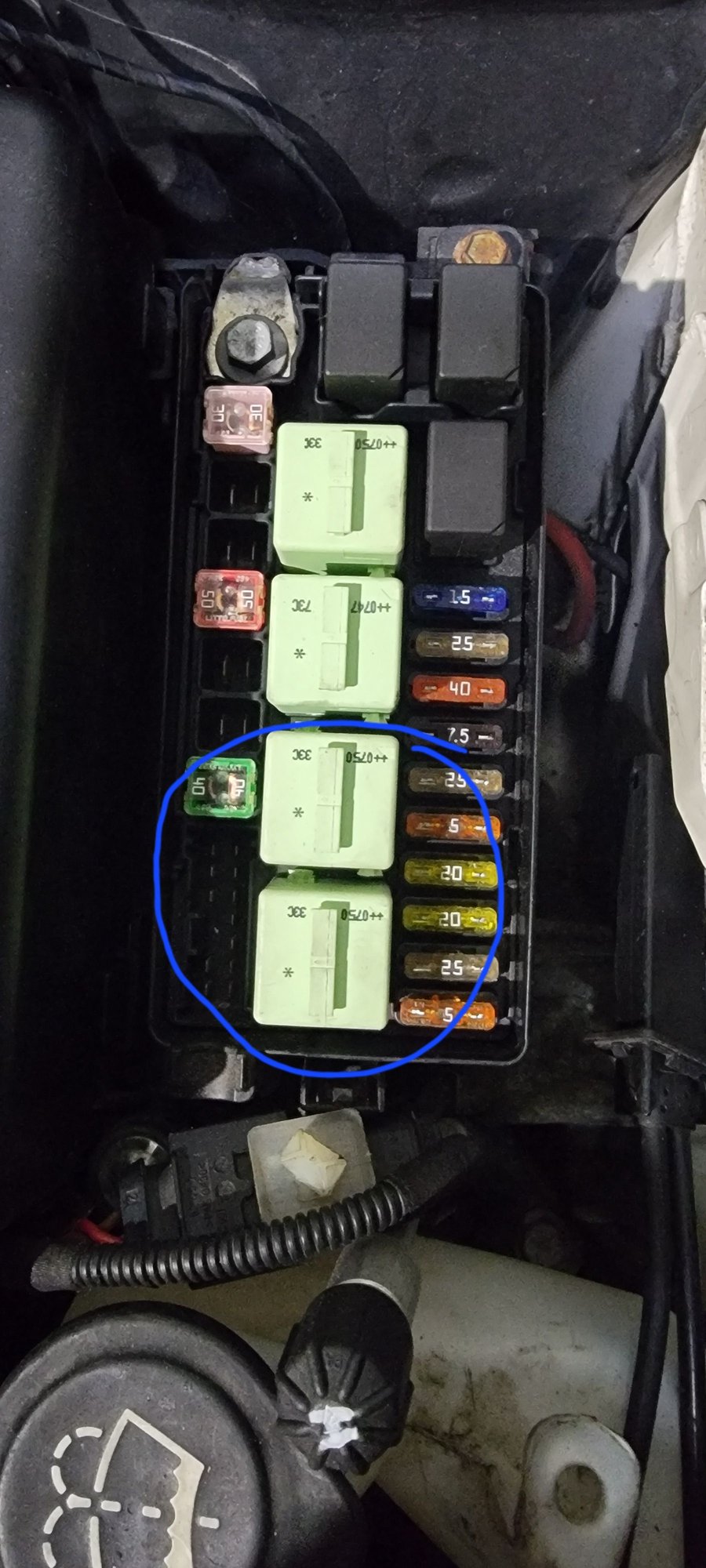

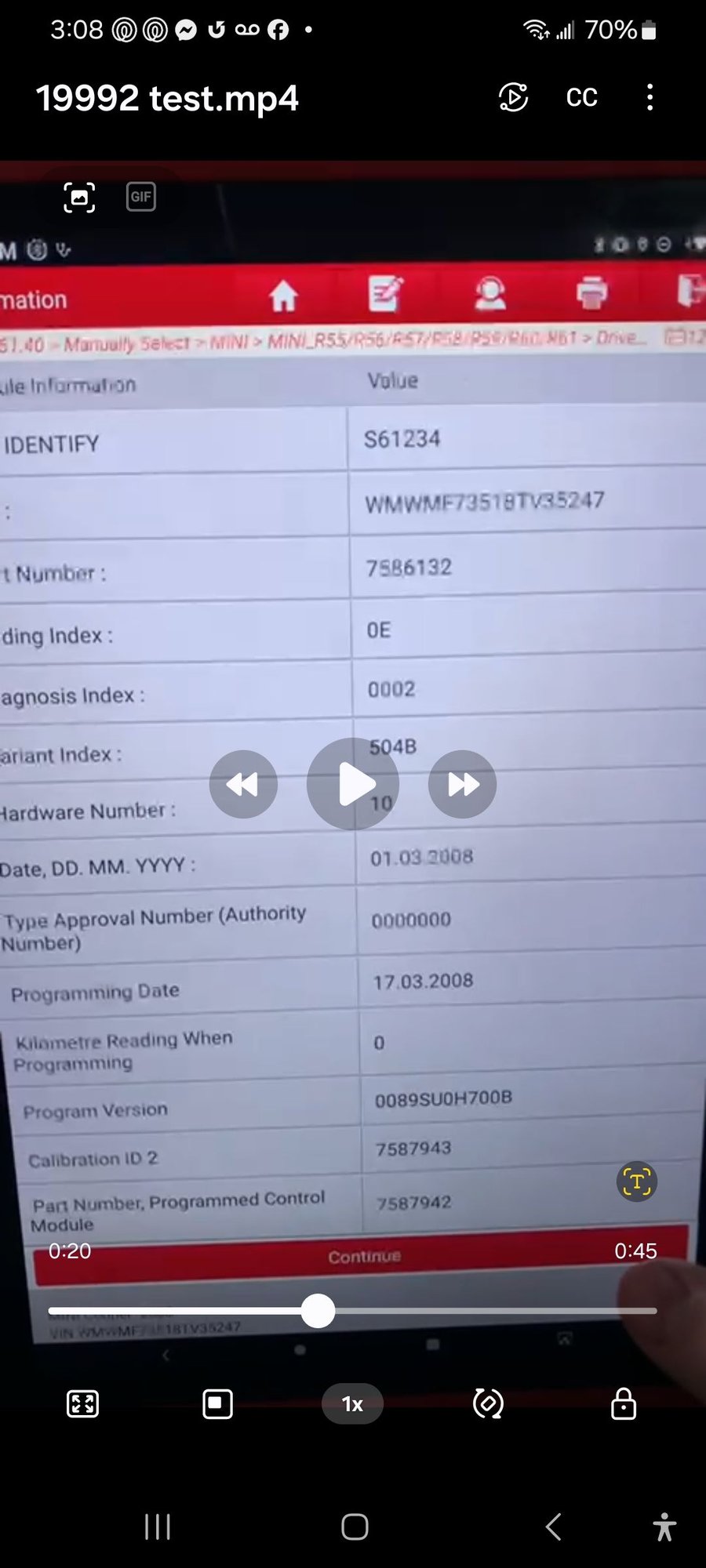

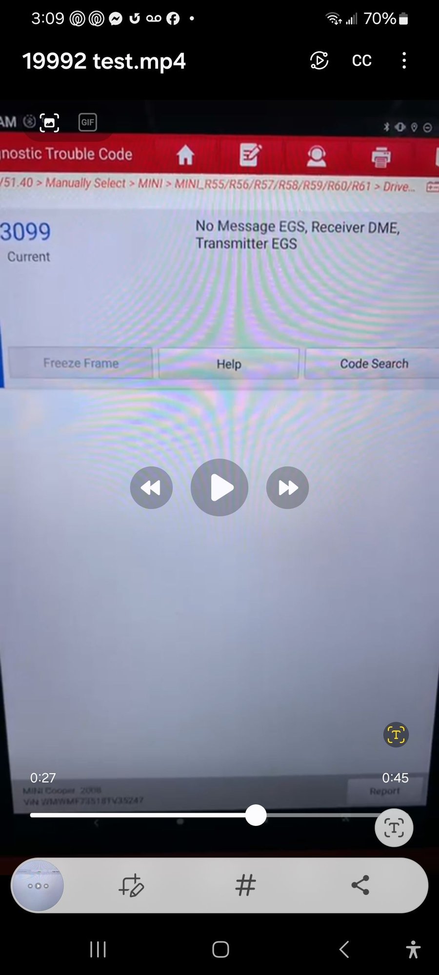

Had this code pop up while driving. When I parked the car, I shut it off and when I came back to start it, nothing. Gauges and everything works just nothing as far as cranking it over...

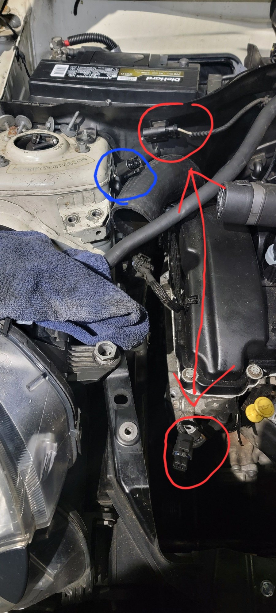

I changed alternators, since I had a new one that I hadn't put in yet and still nothing....I tested the wire from the alternator (Red) to the starter and it ohmed out good, tested the wire from the starter to the battery connection terminal (Blue) and same thing. Tested the voltage from the battery to starter and had 6.9v. Also tested the fuses (Circled in Blue) in the engine and circuit opened and closed and had great voltage. Any help from someone that delt with this is greatly appreciated....also can a dead remote battery cause the car not to start? Also sent Computer, Bas, and key off to get tested and it fired the car right up with no codes...the error code is stated to me that they used a manual while my car is a automatic...
