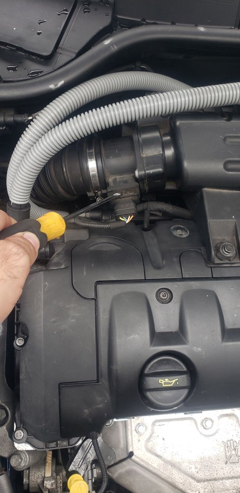

Default Where is the MAF in a 2009 Mini Cooper without turbo?
I am also getting issues with the same model, however, the MAF doesn't seem to be in the same place as any of the other models, where do I find it?
Old Sep 9, 2021 | 04:17 PM
  #8
Mnkytweet's Avatar
Joined: Sep 2021
Straight back from the oil fill cap
