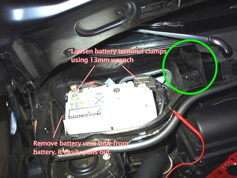

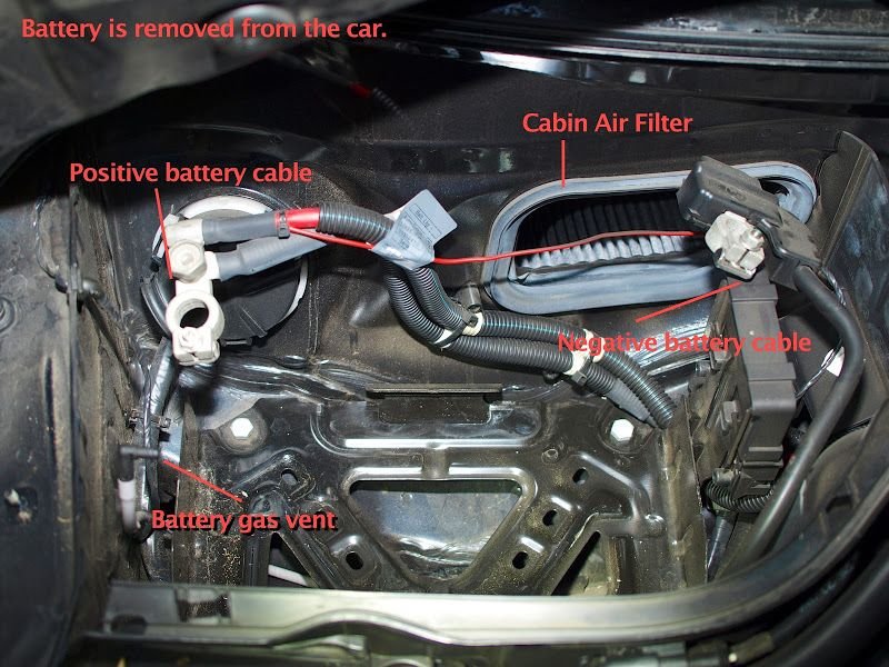

We located the cabin filter intake behind the battery but there wasn't a "flap" of any sort, just an opening. We're still not sure how the critter was dragging so much insulation into the area. The cowling cover was secure, etc.
There is a square opening next to the intake that appears to go straight down. Without putting the car on a lift I can't be sure if it's open under the chassis or not. I'll post a couple of photos for reference.
The owner's going to ask about it the next time he goes to the dealer.

Is there a cover over the cabin air filter opening, or is it just as pictured? No wonder critters can get in.
It's been five years since I helped our neighbor and as far as I can recall there wasn't a cover of any sort. @Minitobe mentioned a "flap" in an earlier post, but as I replied there was no flap. It didn't look like there was a place for a flap, but someone that's more experienced may be able to answer your question, possibly post a photo.
Our neighbors sold that Mini and bought a new Clubman so I can't check anymore.
Or, if you have one, maybe you could look when you have time?
Sorry I couldn't be of more service and best of luck!

I have mine apart currently, and it looks like the picture...wide open. Shouldnt there, at least, be a screen? Guess I'll look for a parts breakdown.

No screen, its open like that
