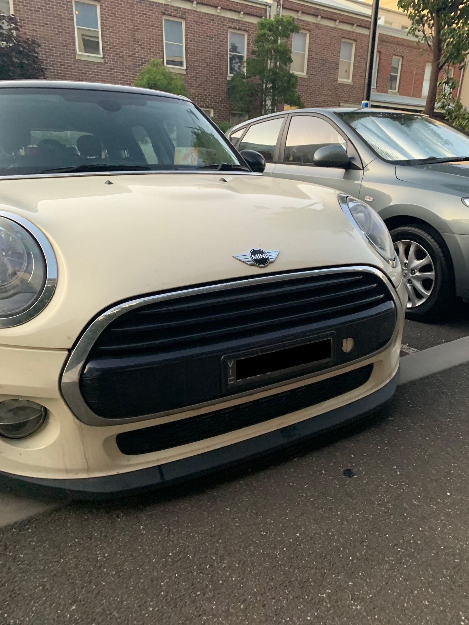

Hey there, hope everyone is well in these hard times.
I have come here in need of help! I wasn't able to find the part online and I'm sure someone here will know the answer, I'm just praying its not an expensive one!
I have noticed someone has reversed into my 2017 min which has left damage to the plastic front plate my number plate sits on - I have attached an image for reference.
I'm wondering can I get this section replaced or will I need to replace the whole grill? If I can get a replacement part where should I be looking and is it easy enough to install?
Thank you for reading I'm hopeful it won't be too expensive :|

Hello,
Looks like you have non PDC ( Parking distance control) since you dont have the little circles on the bumper OEM part # 51117337791
https://www.ecstuning.com/b-genuine-...k/51117337791/
PDC version is here:
https://www.ecstuning.com/b-genuine-...k/51117379434/
Install DIY https://www.realoem.com/bmw/enUS/sho...06#51117337791 #3
