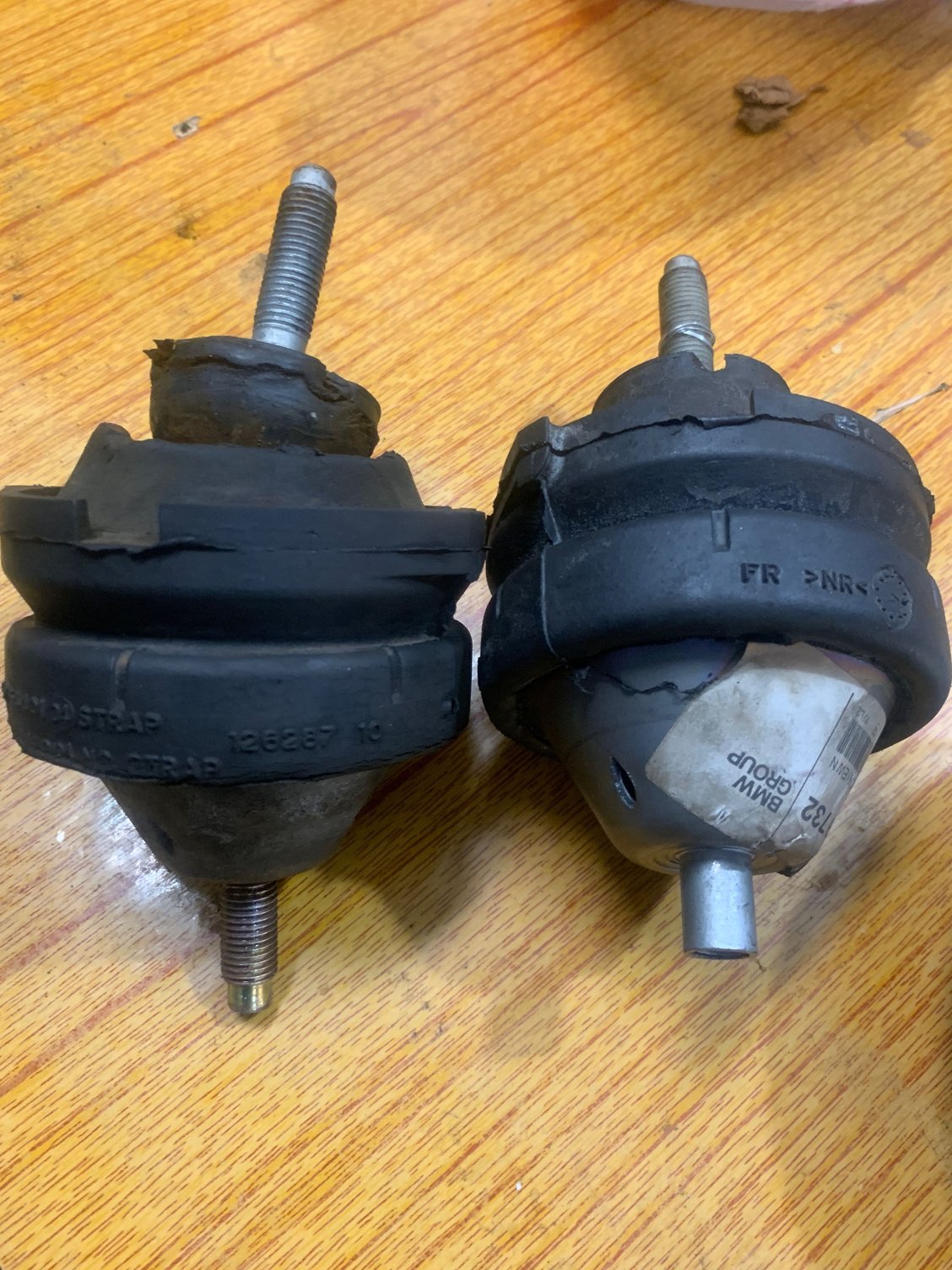

Hi Guys,
I bought the front engine mount based on my vin number but when I removed the one fit in my car I notice it was different. Mine has a bolt in the lower side and it was screwed to the chasis while the new one has a small tube to secure it to the chasis with a bolt.
I've been searching the web but all I can find is the one I bought.
Could some one please let me know where can I buy the correct one?
my mini is an r50 2002 built in dec 2001
Thanks!

hey did you ever
it out? Im going thru the same dilema. Please, any assistance will be greatly appreciated. Thanks

What I ended up doing was taking both engine mounts to a welder and he cut out the threaded bit from the broken one and welded it into the new one after cutting the wrong bit. Its working fine no problem!
