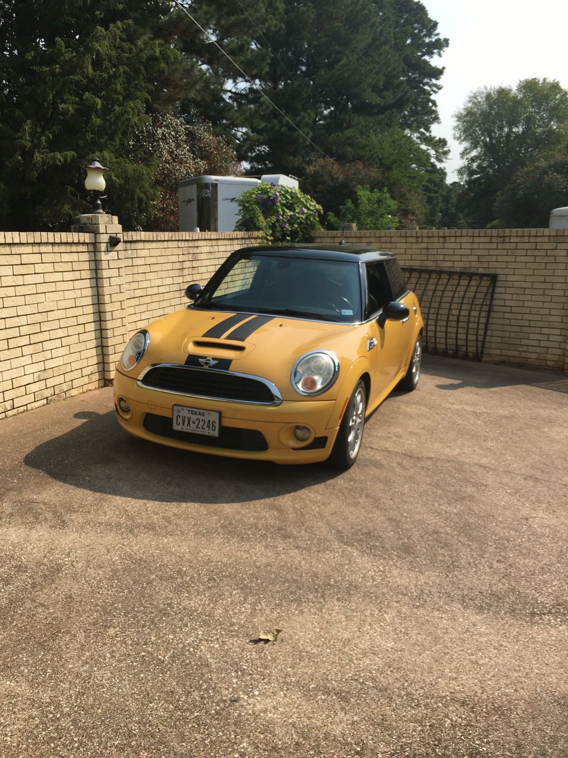

Hi all, brand new to this group and also to Mini Cooper
s. Just bought a 2009 Cooper S. When I start it it runs really rough for about a minute, then it evens out runs fine. When I let it sit a couple hours it does the same thing… But if I start it within 30 minutes it runs fine. Someone told me it could be the fuel pump…Does that sound logical? I priced the fuel pumps and it looks like you’re about $1300. I hate to add that to the price I paid for the car!!! thanks for the advice
