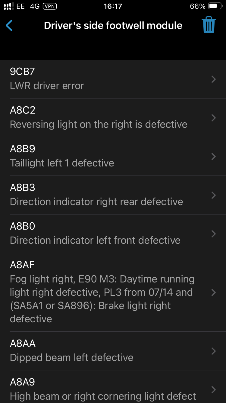

A few days later I started getting intermittent issues with the indicators, then last week I got a whole host of error codes (12) at once from the footwell module.

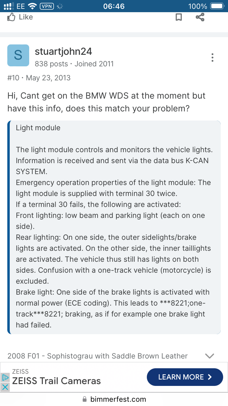

ive scrolled through tons of forums and YouTube videos for help, the only thing ive found as an explanation is the light module going into emergency operation. whereby I only have the function of one light of each set??? Even after clearing the codes they instantly appear.

I am struggling with is to check areas associated with terminal 30A,

The error codes are
9CA9 (terminal 30A connection faulty)
9CB5 (deep discharge battery) after the new battery installed
A8C2, A8B9, A8B3, A8B0, A8AF, A8AA, A8A9, A8AD, A8AC, 9CB6

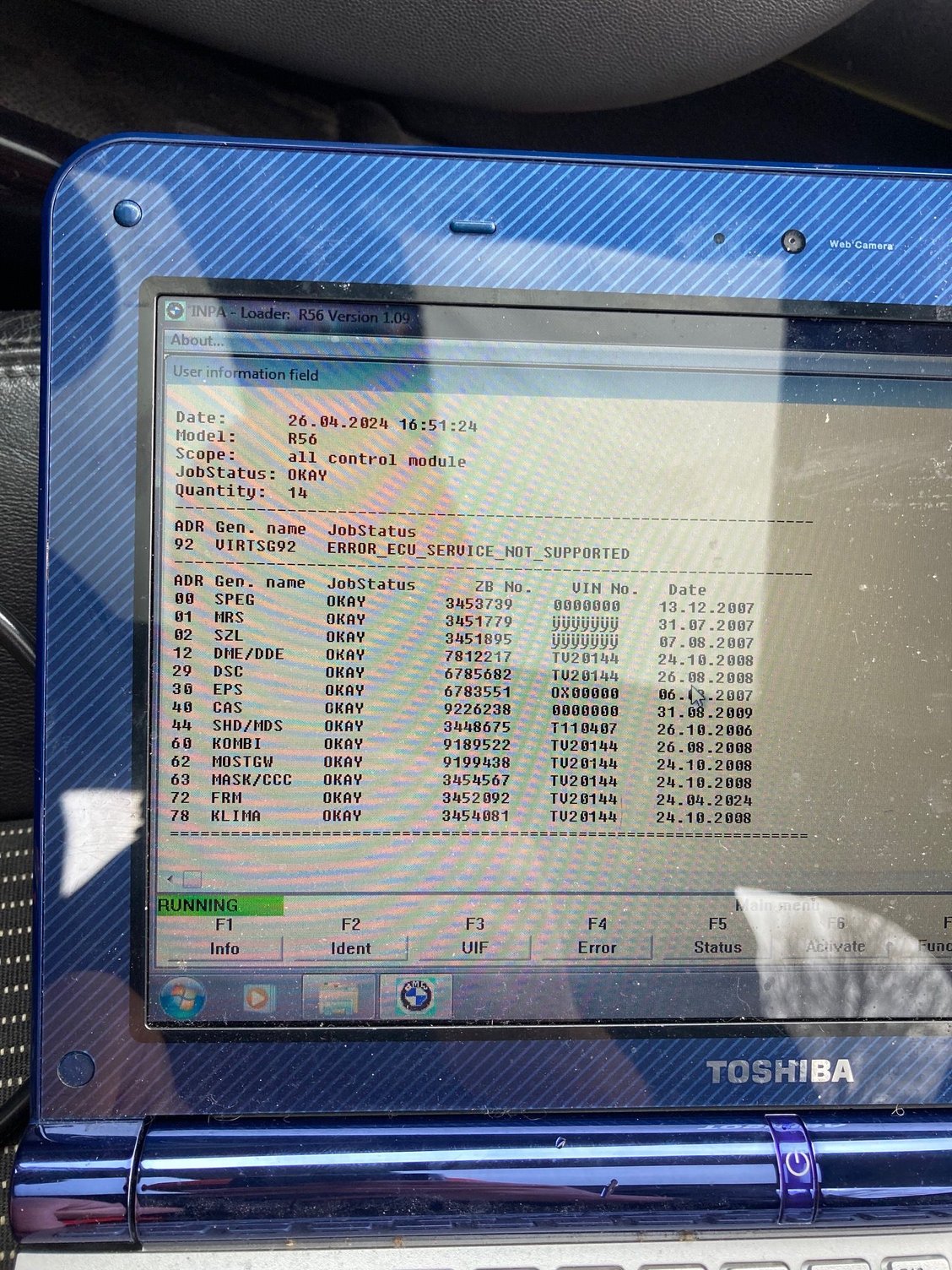

Ive attached some photos to help the explanation

This is the best explanation could find online

INPA ecu information
