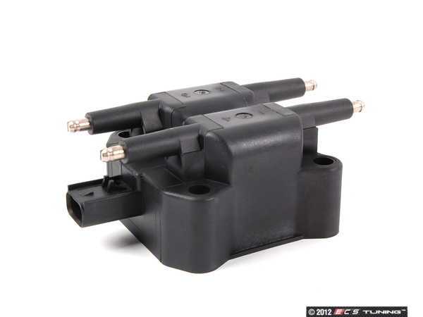

Fuel pump , injectors and starter is ok and turning the engine. Battery is good?
Can you tell if you are getting spark. The Coils can fail or develop rust at the connections between the coil and the spark plug wires. Also check the interior connection of the park plug wire to the coil for rust. Clean them out. Check for rodents that like to chew on them.

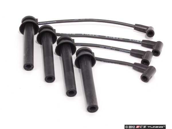

I would check for spark, if the pump is good and you are getting fuel up into the cylinder, then I would look at the coil pack, plug wires, and plugs. If no spark from all 4 plugs look at the connections or the coil pack itself. Also make sure someone did not unplug the coil pack wire harness plug and did not clip it back correctly. It plugs into the coil on the left hand side on the coil pack.
R50 R52 R53 Spark plug wire sets: at the set
http://www.ecstuning.com/Search/12127513032/
Thanks and let me know how it goes. What year R50 do you have?
